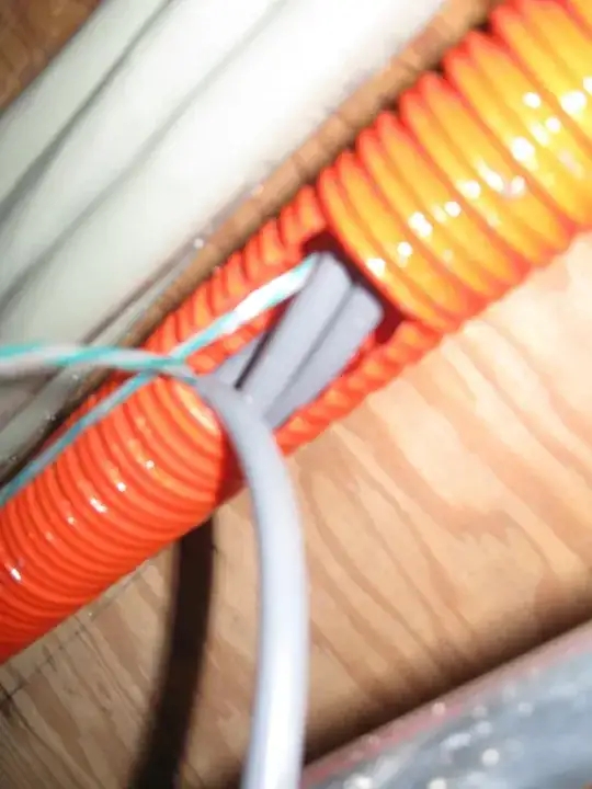

Fiber conduit: Fiber conduit

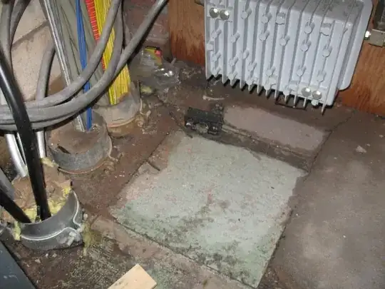

Vertical riser, going down: Vertical riser, going down

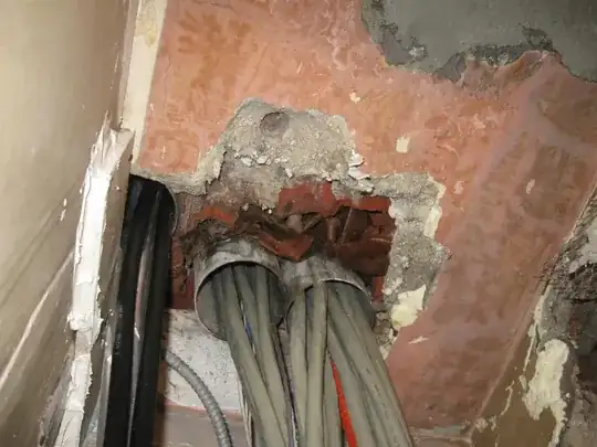

Vertical riser, going up: Vertical riser, going up
Does anyone have any experience with this sort of damage and how to deal with it? Should we just ask the insurance adjuster to add "pull new structured cable" to the list of things to be replaced?
And, if the opinion is "replace it because it'll start failing randomly over time" please include links that describe the specific failure modes, so I've got some ammo to use with the adjuster.
