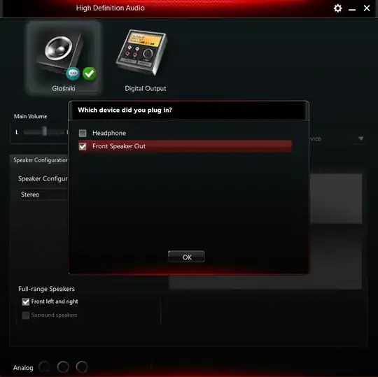

just fixed my problem. Non of above solution worked for me. So what i did: opened Realtek HD Audio manager, clicked analog input (the first plug of the three on the left - matching my ports status) on the very bottom left and set that i plugged speakers not the headphones. But watch out - this settings could re-set -.- enter image description here
Y.A.P.
    The solution you describe is a solution to another problem. The author's problem was specifically surrounding a Dolby audio mixer setting – Ramhound May 23 '18 at 13:35
