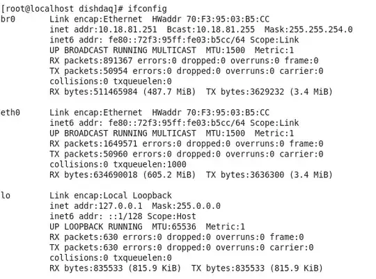

I am trying to host a Shiny R Web Server on a CentOS Virtual Machine. I am troubleshooting some networking issues, but I want to confirm that the port is open.
I have a Static IP address for this Virtual Machine, but when I navigate to Static_IP_Address:3838/ , the connection times out. So, is Port 3838 open?
Update: Here is the outcome of nmap: enter image description here

  • is virtual machine network device bridged ? is VM (with shiny server) pingable from outside ? – Archemar Nov 30 '15 at 15:40
  • The VM network is bridged. I can ping the VM's static IP address. How do I ping the VM's static IP address with the shiny server? – Gary Nov 30 '15 at 15:47
  • Did you run the `nmap` from the machine in question or another one? If you ran it locally you might not actually get blocked by the firewall, you should try running it from another machine – Eric Renouf Nov 30 '15 at 16:04
  • I ran nmap from the host machine. Let me run it from another machine. – Gary Nov 30 '15 at 16:05
  • Thanks for the help, Marius. Just two more questions... Could there possibly be an issue with how the static IP Address was created by my IT team? Why doesn't 10.18.81.251 show up in the IPv4 Route Table? – Gary Nov 30 '15 at 16:50
The above cannot tell you whether the port is open, only whether there is anything listening on that port. And there is, as you can see from the first line, which laso identifies the program listening as shiny-server, as per your desire.
The command to see whether the firewall is guarding the port is nmap.For instance,
# nmap -p80 192.168.73.96

In your case substitute 3838 in the command to 80. Closed means there is no program listening on it, while you are hoping to find open. There are several other possibilities.
Most likely, you are having a routing problem. You should look at your routing table, and see whether it can reach your VM.

For posterity purposes, I wanted to post an answer to how I finally got my Shiny Server up and running.
  1. I disabled iptables:
/etc/init.d/iptables save
/etc/init.d/iptables stop
chkconfig iptables off
  1. I changed /etc/shiny-server/shiny-server.conf to listen on Port 8080 instead of Port 3838. On Port 3838, I could not access the web application from any other computer on the network. But from Port 8080, I could.
Gary
  • 163
I experienced the same issue, but for me the solution was with the internal firewall of Centos 7, so I enabled it, and restart:
#firewall-cmd --permanent --zone=public --add-port=3838/tcp
#firewall-cmd --reload
found the answer on the centos forum working with different ports, source: https://forums.centos.org/viewtopic.php?f=47&t=57945
