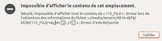

I first opened the SD Card folder in Nautilus, and I got this error:
error when reading with Nautilus Quick translation: Impossible to show content of this folder, I/O error on weird filename
This weird file was nowhere to be seen in Nautilus. Moreover, when right clicking on the "112_FUJI" folder, selecting "properties", it tells me that the folder holds for more than 21GB of data, and the SD Card has a capacity of 8GB...

You may well be close to the end of the line for "regular" data recovery. What I would do is use (GNU) DDRescue to make a bitcopy of the SD card - or as much of it as you can get, and then try use Testdisk to Repair the FAT Tables (ie by looking at the backup copy of the File Allocation Table)
You might also - on a bit copy of the drive, attempt to run checkdisk /f to try and force it to fix the drive - this might help - it might also make the problem a lot worse.
Its anyones guess how the problem happened - the card going faulty is, I suspect the most likely cause, it could also have been a problem with the firmware/software in the Camera, and/or maybe it came loose during the middle of a write.

  • I managed to get a few files back by using `chkdsk /f`, some others seems to be lost for ever. It did nothing on the files with strange names thought. Thank you – Tloz Mar 17 '16 at 01:36
