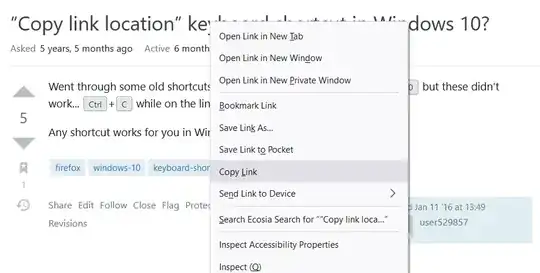

If the link is in focus then you can simply press ≣ Menu+L with menu key being the key on the right to activate the context menu. Alternatively Shift+F10 also activates the context menu, then L will select Copy Link
If you prefer to use both mouse and keyboard like this top-voted solution then in Firefox just use Right-click+L
Notice the underline below L in Copy Link. If it's different in some other languages or in another Firefox version then just replace L with the corresponding character in your case
Firefox Copy Link shortcut
