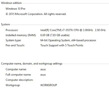

Laptop: Asus UX31A System: Windows 10 64-bit (upgraded from 8.1), latest updates installed HDD: 256 SSD ADATA
system infor screenshot
Recently I've been experiencing system freeze for 10-60 seconds, and by that I mean that the system is completely unresponsive, nothing works (nor mouse or keyboard).
From the observations I can tell that this is not a HDD problem as this is hardly utilized during the freeze time, but what caught my attention was the memory.
As I was installing some updates for visual studio and running some other developer tools, I've noticed that the system went into a freeze mode almost on anything I've done, click the start menu given the example, or just clicking on the windows explorer window.. so I've looked at the task manager and have noticed that once the system has hit around the ~30% memory utilization the system locks were more often. As soon as I've released the memory by closing as many process as I could it became more usable.

  • Sounds like it could be bad ram. Try running a program like Memtest on it. – Scott Chamberlain Mar 01 '16 at 22:38
    2 of 4 means you only have 2 memory modules nothing odd about that – Ramhound Mar 01 '16 at 22:38
  • How many sticks do you have installed? Are you saying you have 4 x 2gb making the 8gb? Could be that 2 have failed? Or they aren't the exact same; I.e. speed, etc... (although I'd have thought you would have encountered other errors if that were the case) – James Mar 01 '16 at 23:40
    I think any connection between memory use and freezing is coincidental. You have plenty of RAM available, so it's very unlikely that has anything to do with the freezing. It could be a bad driver, overheating, or any of a number of things. Does your fan sound normal? Is it spinning more often or more quickly than it used to? – David Schwartz Mar 02 '16 at 00:29
  • Thanks for the replies. I don't know the exact memory configuration as I don't want to break the warranty, but from the specs it should be 2x4GB soldiered on. The overheating is not a problem, no problem with the fan. Windows 10 freeze problem is quite common but the reasons might differ. Yes, I do have a plenty of RAM, but I question why when I try to put some heavy load on it (by opening more and more programs) it never goes above that ~30% mark but starts troubling instead. – belzebu Mar 02 '16 at 00:33
