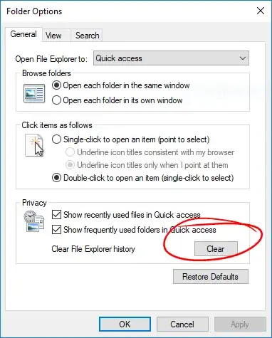

The only thing I found to work was opening a folder (not from the one in the taskbar, but one on the desktop or other means). Below are those steps for Windows 10 Pro:
  1. Open a folder
  2. On toolbar go to View -> Options (far right) -> Change Folder and Search Options
  3. Under Privacy click Clear next to Clear File Explorer History Screenshot
  4. Click OK and close the folder. Now open the folder from the taskbar.
THIS RESOLVES THE ISSUE SINCE A FILE THAT IS STORED FOR QUICKACCESS MAY NOT BE ACCESSIBLE.

    Unfortunately this doesn't work when Explorer is *"Working on it..."*, because the **Options** button on the **View** tab is disabled. – Ian Boyd Jul 13 '18 at 22:49
  • I tried manually clearing the AutomaticDestinations folder and setting the Quick Access to This PC. Pressing the Clear button on Folder Options is what finally fixed it for me. Thanks! – Paul Williams Nov 18 '18 at 18:03
  • it works but after i restart the computer it happens again... any permanent solution to this? – Jayant Kaushik May 05 '20 at 16:13
  • You can access this dialog only when you have a working explorer. So if your explorer already doesn't start normally, you have to trick it into opening some other folder on your disk, then immediately go the this dialog. – E. van Putten Jul 14 '20 at 12:04
