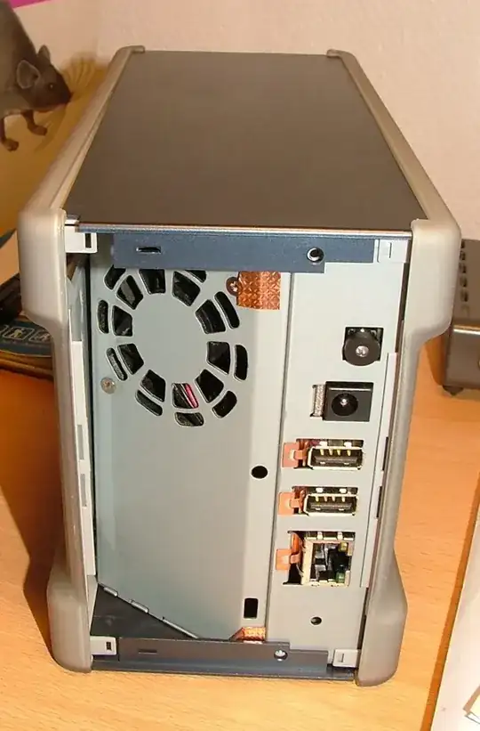

Anyway, the question at hand is how to get my data out of it? As a very concrete first step, is there a way to open this thing without breaking the plastic casing into pieces? It is far from obvious to me how to get beyond this stage:

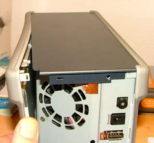

It opens a little from one end but not from the other:

  • in your pic of the slight opening on the back, you can see a hook-tab holding the side-piece in place. there'll be another at the front end of the device -- most likely the front panel (with the buttons) will pop off, and expose screws and a way to get to the front hook-tab. – quack quixote Feb 14 '10 at 04:52

Opening the case
Pull the gray side panels slightly apart at the front. Then lift the back of the dark "wrapper" piece (the one on which you loosened the two screws) and slide it forward. Do this both at the top and the bottom, then the wrapper piece will come off.
For the not-so-faint-of-heart: you might just as well rip the wrapper piece off – this will break all the tabs, but if you do decide to piece your MSS II back together, the two screws of the rear panel will still hold it in place.
You should now have exposed two screws on the front panel. Loosen them, and the two pieces of the metal case will slide apart.
You can then take out the disks. They are plain SATA disks, which you can install in a standard PC or USB enclosure.
