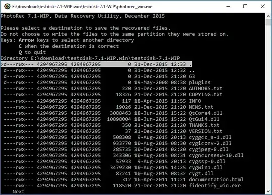

It's go time
The shown folder will appear, and the recovered files will go in there. After 500 files it make a .2,.3,.4,.5 and etc folders.
