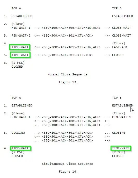

rfc793: image source
enter image description here image source
