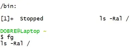

What happens if you forgot to add the nohup Command at the beginning of your Command?
Let us say that you have run the following Long Command:
The beginning of the Output of a Long Command
This is called as ls -Ral / that is supposed to list all of the Files and all of the Folders, including the Hidden ones, with a Long Format, Recursively starting from the Root Folder. It might take a while.
Just press ctrl+Z.
Stopping the Long Command
How do you get it back?
The Command to get it back into the Foreground is fg.
Bringing the Command back
