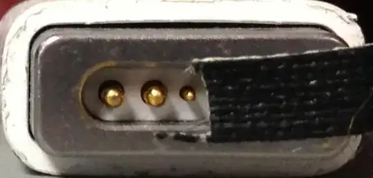

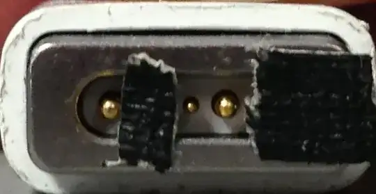

To prove this, I put non conductive tape over different combinations of positive and negative pins. As long as the center pin, and one ground and one positive pin made contact, my laptop successfully charged.
Connectivity Test
Still worked in both orientations without these pins
enter image description here Still worked in both orientations without right most pins
As soon as I covered two matching pins (i.e... 1 and 5 or 2 and 4) the laptop failed to charge.
