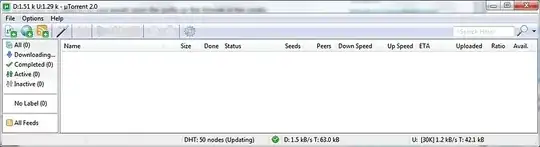

Starting with gadzooks64's answer...
All you really really need to look for is the green connected logo in uTorrent's status bar:
alt text
If that's on, then everything is configured as it should be.
