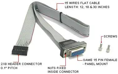

If I remember correctly the 15pin port is "game port", not true serial port. Thus you can't convert it the way you are thinking.
Sometime I have seen them called "COM2" but that is a mistake on the board manufcaturer's side.
The correct cable and external port is this:
TomEus
  • 3,657
  • This wouldn't work in this situation. Lenovo are using their own bespoke header so you must purchase the part from them. Not cheap either! A new one is over £100 on some sites. – Andy Foster Nov 11 '16 at 15:58
  • OK, good to know, thanks for the update. All my PCs are using generic MBs like Asus so this was a blind shot.... – TomEus Nov 11 '16 at 23:20
