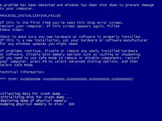

Unable to boot into Windows and Safe Mode - both return the same blue screen. Most online resources explain that the bootcat.cache (in %windir%\system32\CodeIntegrity\) may be corrupt or the size of the file has unexpectedly changed.

    Any other error information on the BSOD besides `process1_initialization_failed`? – I say Reinstate Monica Jan 20 '17 at 15:07
  • MS lists some causes in MSDN: https://msdn.microsoft.com/en-us/library/ff559142%28v=vs.85%29.aspx look what may apply to you – magicandre1981 Jan 20 '17 at 16:25
  • @Twisty Updated the original post. – root Jan 20 '17 at 21:00
