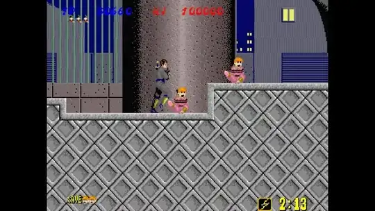

I recorded a game using fraps. The recorded video looked great.
Then I edited the video and encoded it with Huffyuv lossless codec. The video looked great.
Finally, I encoded the video with x264 in FFmpeg and the colors looked washed out.
Screenshots:
Huffyuv (looks great):
Original
x264 (looks washed out):
Copy
x264 settings:
ffmpeg -y -i "D:\Project\TestHuffyuv.avi" -c:v libx264 -b:v 1000k -pass 1 -passlogfile D:\Project\Stats -f mp4 NUL
ffmpeg -y -i "D:\Project\TestHuffyuv.avi" -c:v libx264 -b:v 1000k -pass 2 -passlogfile D:\Project\Stats D:\Project\FFmpeg_MP4.mp4
When I was encoding with x264, I got the following warning:
No pixel format specified, yuv444p for H.264 encoding chosen.
Use -pix_fmt yuv420p for compatibility with outdated media players.
How do I fix the colors so they look the same as in the original video?
