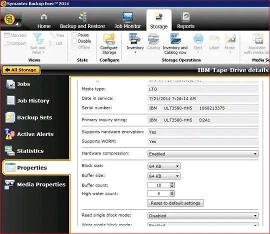

  • IBM LTO5 (IBM ULT3580-HH5) standalone tape drive is attached.
  • Hardware compression is enabled in storage properties.
  • BE Storage option 'Hardware if available otherwise none)

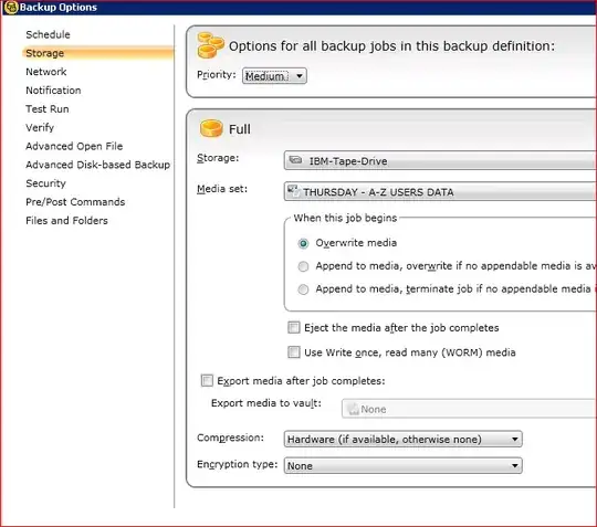

  • We always select 'Overwrite Media' option in job properties to overwrite any existing media on tape.

  • In Job Log, I can see this entry "Compression Type: Hardware"
