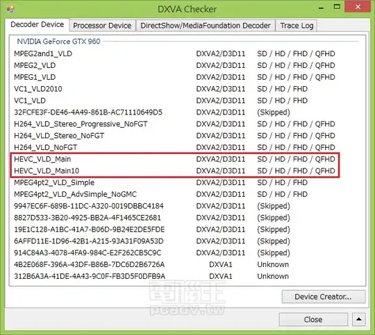

From this Cyberlink forum post it appears that the 960 and 950 Nvidia cards report that they have this profile, but it does not work fully. My suspicion is that the video file is just too large in resolution.
On the 970 the video decoder is slightly older and as such does not support h.265/HEVC at all while the decoder in the 960 is newer and apparently should support both Main and Main10 profiles. That you have different support for video decoding within the range could be disappointing.
