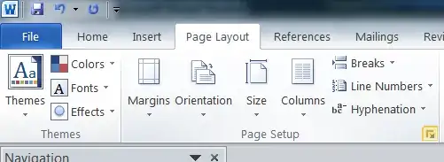

I don't agree with the accepted answer being the "best" answer.
On the Page Layout tab of the ribbon control, click the little button that points to about 5:00 (lower right hand corner in his pic).
This brings up the Page Setup dialog. At this point, select the Layout tab and select Center from the Vertical Alignment drop down list.
