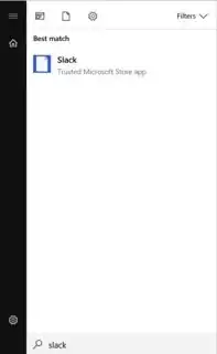

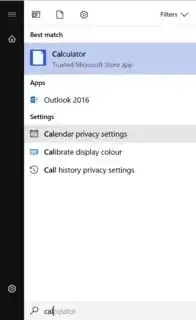

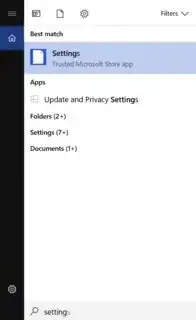

When Using Search
Searching in the start menu won't show the icon for Trusted Microsoft Store apps. Other app icons are visible in the search.
Slack icon missing Setings icon missing Calculator icon missing, other icons showing

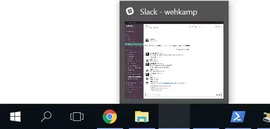

Not visible in taskbar either
Here you can see that both the Slack and Store app icons aren't visible on the taskbar:
Slack Icon missing on taskbar
