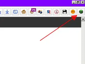

I want to quickly restart Firefox, not losing any tabs that are still open before the restart.
Use the Restart Browser add-on:
Allows to restart the browser with a button.
Confirmed as working with Firefox 61.0.1:
DavidPostill
