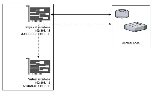

How can I create a virtual interface, that connects to the same network as the physical interface? I tried searching around but all I found is loopback. I need the other end of the wire recognizes this as two interface, so loopback won't do it. Hypervisors like VMWare have an option to do exactly this (VM and host are recognized as two devices on router's arp table), but in my situation using a VM is pretty much overkill. I just want another connection, or maybe some apps that can behave as a "virtual switch".
I'm on Windows, and it should be like this.
Expected_Virtual_Network

  • My OS is Windows 7. But I can move to windows 8.1 or 10 if needed. – tvc Feb 28 '18 at 04:32
  • ?? https://technet.microsoft.com/en-us/library/bb740792.aspx – Tony Stewart EE75 Feb 28 '18 at 04:45
  • That kind of defeat the point since I'll need a hypervisor anyway. Or do I? – tvc Feb 28 '18 at 04:47
  • So apparently there are no separate app that can do this and I have to move everything to windows 10 but anyway, thank you. – tvc Feb 28 '18 at 05:10
  • The problem is a full-blown VM is overkill when all I need is just a virtual interface. – tvc Feb 28 '18 at 06:00
  • nvm. I got my job done using a spare linux box with a couple ip link adds. But if you can provide the procedure on Windows that's fine too, I'll mark it as answer since I'm originally asked for Windows. – tvc Mar 01 '18 at 09:21

Procedure for Linux:
So originally I'm asked this to be done in Windows. But since the Windows-way will cost me another 2 hours I decided to do this on a linux box. Anyway here's how I did it, thanks to this answer. Hope this will solve someone's problem in the future. In short:
  1. Create a virtual link on your existing interface. You should get a Locally Administered Address (here) to pass in so it won't potentially mess things up (and also a recommended way to do):
    ip link add link eth0 address 56:8A:C0:DD:EE:FF eth0.1 type macvlan
  2. Bring the interface up:
    ifconfig eth0.1 up
  3. And acquire an address:
    dhclient -v eth0.1
Futher reading:
If you insist on a * real virtual * interface, there's a package named vde2 for the purpose of creating virtual switches on linux. Haven't tried that out, but maybe it can helps. It's annoying a little bit that such 'small' tool doesn't exist in Windows.
(Yes, I'm creating a link, not really an interface. But it did get my job done. I'm sorry if my question is misworded, you can edit it to clarify. But in the end of the day it shows up as an interface and traffic did goes thru that interface so probably it is solved?)
tvc
  • 512
  • What is `macvlan`? Does the virtual and real network interface both work simultaneously? Can I add more than one? Can disable the real one and enable only the virtual one? – Biswapriyo Mar 02 '18 at 09:23
    `macvlan` type link denotes a virtual interface based on link layer address ([source](http://manpages.ubuntu.com/manpages/xenial/man8/ip-link.8.html)). I needed *another MAC address*, not just another IP so macvlan is the appropriate virtual interface type. – tvc Mar 02 '18 at 10:09
    In my case, yea, it did work simultaneously. Never tried to add another one but i believe there can be several virtual interfaces *inside* one real interface. Because of that i also think disabling the real one will take down the rest virtual ones too. – tvc Mar 02 '18 at 10:13
