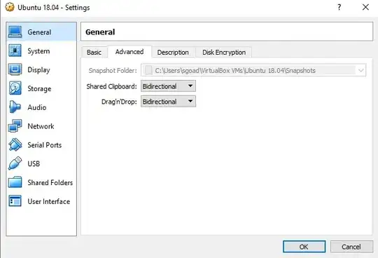

This should enable clipboard sharing. Make sure that Clipboard Sharing is set to Bidirectional under VM Settings in VirtualBox as seen here:
Clipboard Sharing in VirtualBox
