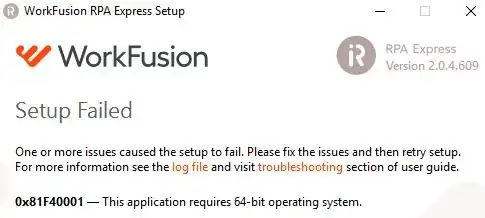

I'm running Win10 on a virtual machine and when I try to install a new program I get following error:
So I check the log file and find this:
[20F0:2574][2018-07-26T19:39:32]i052: Condition 'VersionNT64' evaluates to false.
[20F0:2574][2018-07-26T19:39:32]i000: Condition failed: This application requires 64-bit operating system.

    Hyper-V is 100% compatible with AMD hardware. If your CPU does not support virtualization then what you want cannot be accomplished with your hardware. VirtualBox is not compatible and cannot be ran if you enable Hyper-V. Edit your question to indicate what your hardware is, and provide English translations, for error messages – Ramhound Jul 26 '18 at 19:37
  • @Ramhound I added the name of my processor, there's no German error msg that is worth translating here, everything important is already in English. If there are any more hardware parts that can affect virtualization let me know and I'll add them. Thanks for the Hyper-V not compatible with VirtualBox information...but I'm more interested in how to make 64bit work in my case. – Cold_Class Jul 26 '18 at 20:00
    Provide a screenshot of the system properties, that indicate, you actually have 64-bit Windows 10 installed. What is your host running. – Ramhound Jul 26 '18 at 20:29
  • @Ramhound alright, I added that information of my host. It is indeed Windows 10 64bit – Cold_Class Jul 26 '18 at 22:07
  • @Ramhound AH, I think I found the cause! I checked the operating system properties in the virtual machine, and it says 32bit operating system!! I think now I should be able to fix the problem by myself! :) – Cold_Class Jul 26 '18 at 22:10
  • That’s what I wanted you to provide anyway – Ramhound Jul 27 '18 at 00:38
  • Let us [continue this discussion in chat](https://chat.stackexchange.com/rooms/80758/discussion-between-ramhound-and-cold-class). – Ramhound Jul 27 '18 at 11:23
My initial thought "it's 32-bit" was correct, I just got confused by that "64-bit"-selection (2nd screenshot). Turns out, that selection is correct though, because when I change it to 32-bit I can not start the vm anymore...but that wasn't the problem here.
The problem was that I didn't have a 64-bit Windows operating system on my vm. So I searched around on here, found how to get it, and created a new vm. For that specific program I was trying to install, I additionally had to turn the RAM up to 8Gb and then finally everything worked!
