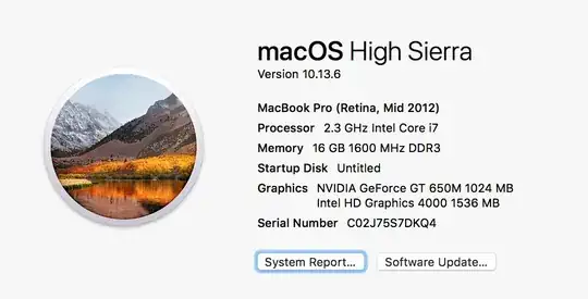

I get a new battery from a repair shop yesterday for the MacBook Pro and the configuration is provided below,
I read that the battery life for the new installation should be about 7+ hours while I get only about 2+ hours now. The battery configuration is provided below,
I get the percentage here,
Is the installation is a new battery or the dealer is deceiving me with an old one? The cycle count is 0, so it might be a new battery. Then why the battery time is so low and also, the time is fluctuating?

    Was the battery cheaper than buying an "official" one? Did you "calibrate" the battery (basically charge fully, turn off & keep charging, drain battery, let sit, charge again)? – Xen2050 Oct 04 '18 at 03:54
    I live in south-east Asia now and don't have access to the Amazon or similar services. Also, it takes 2- weeks time for shipping. It was charged all night to the fullest when plugged in. This is the first time I use after replacing the battery. So, it never drained to the bottom. The cycle count is 0 is that mean the battery is new? I didn't know about the calibration but maybe that is the issue. – Arefe Oct 04 '18 at 04:00
  • The battery is not cheaper I paid $94.30 for the battery, we have high import tax for the electronics – Arefe Oct 04 '18 at 04:01
  • Sounds like you got a bargain, [Apple says "battery service" for a Macbook Pro Retina is $199, US I'm assuming](https://support.apple.com/mac/repair/service). Anyway I'll post an answer about Macbook battery calibration, that should at lest help some – Xen2050 Oct 04 '18 at 04:07
  • @Xen2050 sure, that will be very helpful – Arefe Oct 04 '18 at 04:11
    Interestingly, as hour passed after I write the post and took the battery life image. it now shows 33% battery life and have remaining time is 1 hour. Soemthing is wrong here, most likely the calibration mentioned earlier – Arefe Oct 04 '18 at 04:13
  • The remaining run time is usually an estimate based on average current power usage. When you first turn it on, it doesn't have much history, and startup isn't typical usage. The initial time estimate can be way off, even if it's calibrated. – fixer1234 Oct 04 '18 at 04:42
  • I calibrated the battery and its providing time about 4-5 hours with moderate CPU usages such as IntelliJ IDE, databases etc – Arefe Oct 05 '18 at 07:35
  • Ah... I still got below 2 hours. Which is sad. – Benyamin Limanto Nov 28 '20 at 05:22
