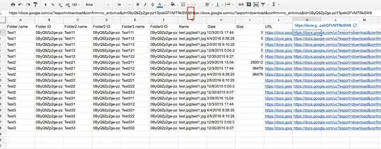

For example if you want cells in column D to contain the product of cells in B and C, and column E contains sum of B and C, instead of using D1 = B1*C1 and E1 = B1 + C1 and drag down you just put the below formulas in D1 and E1 respectively and press Ctrl+Shift+Enter
=B:B*C:C
=B:B + C:C
In Google sheet you'll need to use ARRAYFORMULA function instead of the shortcut like in Excel
=ARRAYFORMULA(B:B*C:C)
=ARRAYFORMULA(B:B + C:C)
After that the formula will be automatically applied to the whole column immediately without dragging anything. X:X refers to column X. If you want to include only from row 3 to the end use X3:X. Or if you want to calculate the result for only cells from X3 to X10003 then use X3:X10003. The same syntax can be used for rows, i.e. 1:1 for row 1. Here is another example from Excel's documentation that calculates the product in each column
