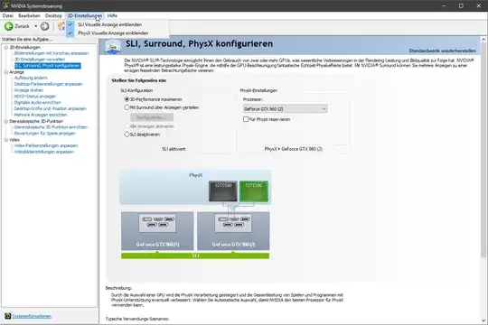

I've just got a second graphics-card and I wanted to try SLI. After I've installed the latest driver for my cards (bother are the exact same model and chip), I was able enable SLI in the Nvidia Control Panel.
Somehow my system is not happy at all with those cards.
I'm getting hard lags in normal operating mode. Windows lags hard, I cannot move or some windows, even the sound is laggy (when running music sometimes there is no sound for 1-2 sec).
I've read, that RAM has to be SLI-Certified and that CPU might be the issue.
How would I track down the source of the problem ?

    Questions: (1) Are you using a two-pronged bridge? (2) Are the GTX cards in PCIe1 and PCIe3? (3) Do you have one or more monitors? (4) Does the NVIDIA Control Panel has in the 3D Settings tree "Configure SLI, Surround, Physx" and is the "Maximize 3D Performance" option set? (5) If you click any link in the "3D Settings" tree and at the top in "3D Settings" see if "Show SLI Visual Indicators" is checked. Post a screenshot of the white vertical bars on the left-hand side of the screen with a green box in the middle. – harrymc Feb 03 '19 at 21:35

  • @Ramhound I was able to enable it. I've turned it back off since I could not operate to the reasons mentioned above. The SLI itself kinda worked. - I will post some updates later when I get home including some images ! – Felix D. Feb 04 '19 at 08:47

  • @harrymc I was about to :D 1. I'm sure I've used the correct pci-e slots. 2. Power is set up correctly. 3. Drivers are latest (by last week). 4. UEFI wasn't checked yet since I struggle to get in there. Since there is a second card the first thing I see is windows login. (1). what is a two-pronged bridge ? - I've used the one that came with the card.. (2) yes (3) 2 monitors (HDMI, DP) (4) yes the settings are there. As mentioned in the question I was able to fully enable SLI. Performance is the problem here. – Felix D. Feb 05 '19 at 08:12
  • A two-pronged bridge is for connecting two cards, since it's possible to connect more than two. The [documentation](https://www.geforce.co.uk/whats-new/guides/introduction-to-sli-technology-guide#5) says "When this link is not present the PCIe bus will become the means of communication, which can degrade performance", so I wonder if the bridge is at all functional. – harrymc Feb 05 '19 at 09:27
  • @harrymc yes, its a two-pronged bridge. – Felix D. Feb 05 '19 at 09:28
  • Software-wise everything looks to be correct. Hardware-wise, the bridge might be defective or badly connected, so the cards are inefficiently using the PCIe bus. – harrymc Feb 05 '19 at 09:46

  • I've testet with a new bridge and it's not working without any lags. FPS are still a little low but at least I can use the system now with both cards active ! thanks alot for your help and time ! – Felix D. Feb 11 '19 at 07:42
