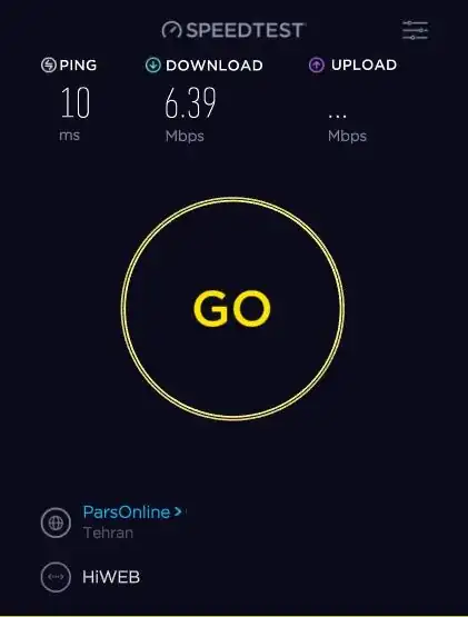

update this is the speedtest.net results I just got!:
I need to know what could have caused this so I can talk to the ISP agents prepared, they have the tendency to deceive people if they know the other person has little/no knowledge concerning the matter at hand.
