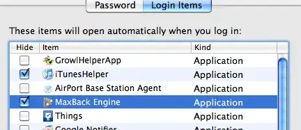

Oh well, it wasn't that difficult after all.
I looked under System Prefs -> Accounts -> Login Items, and "MaxBack Engine" was there on the list, along with the possibility to disable it from starting upon login.
alt text
The tooltip additionally told me the application is at:
/Library/Application Support/Maxtor/MaxBack Engine.app
So, I deleted (permanently) the whole Maxtor directory (it contained another file called "MBHelperTool" along with "MaxBack Engine.app"), and verified (by reboot & login) that it indeed is gone for good now!
