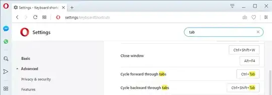

Here's the default Opera settings if you're curious
Opera tab option
Opera cycle tab shortcut
Opera next tab shortcut

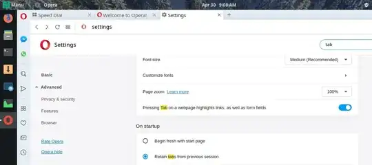

There's even an option for highlighting links and elements while pressing Tab instead of just moving the focus
Tab highlight option

  • @John seriously I don't know why you don't even try or read what I said. I've used Linux for decades and I've never seen such a behavior. **Tab always move focus between elements** regardless of the OS, and in Opera it'll also [highlight elements by default](https://i.stack.imgur.com/Rj50R.jpg). The official shortcut for Opera on Linux is the same as Windows, and **Opera on my Linux uses Ctrl+Tab and Ctrl+Page Up/Down like Firefox by default**. I assure you Tab **cannot be used to cycle through tabs in either Windows or Linux** and it cannot be the default option in any OSes – phuclv Apr 30 '19 at 02:11
