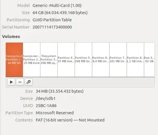

I have a SD card that has some issues and I could not fixed them.
This is how the disk looks like in GNOME Disks: Ubuntu Disks

I actually had this same problem recently. Your SD card may be in some kind of write-protected mode. Possible causes:
  1. The flash memory has worn out and can't be written to anymore. (This is bad!)
  2. The physical write-protection switch may be enabled. (Switch it off to enable writing again.)
In my case, the flash disk controller was silently discarding my writes after the flash memory failed, so even though the writes looked successful, the corrupted partition table came back on the next read.
If your SD card is behaving like this, it has most likely failed, and you'll need to get a new one.
I suspect that you are having the first issue because if the write-protection switch was active, you would be seeing some kind of "read-only" notice, as Linux can detect if a flash disk or SD card is write-protected. (See /var/log/syslog)
