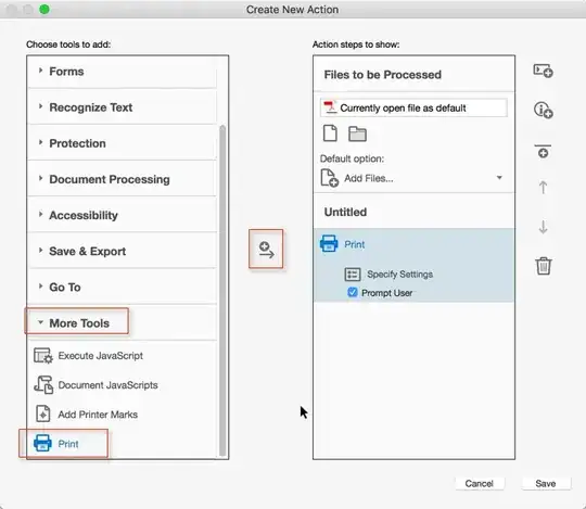

You can use Adobe Acrobat Pro to print to PDF. Adobe Acrobat Pro also allows you to perform batch processing, so you can batch print to PDF.
See https://forums.adobe.com/thread/2540164 (mirror) for more details.
Disclaimer: at the time I write this post (2019-06-01), I work for Adobe.
