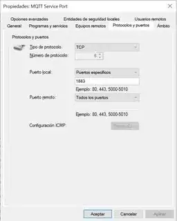

I am trying to connect to a MQTT Mosquitto server by using a laptop with a wireless connection. However, I am getting timeout messages all the time. After doing some research I have come to think that this issue is related to having port 1883 (uncyphred MQTT comms) closed. I have also found a web to test connectivity with a MQTT broker that makes use of HiveMQ (http://www.hivemq.com/demos/websocket-client/) that works in other pieces of equipment whenever I enter a user and a password.
Thus, I have opened an inbound rule in the Windows Defender firewall, as explained in https://www.youtube.com/watch?v=xMGPyZtdP00 or in http://www.bytesofgigabytes.com/networking/how-to-open-port-in-windows/.
port rule
Unfortunately, the port is still not open and whenever I set a user and a password in the mqtt web side i get a "Connect failed: AMQJSC0001E Connect timed out." message. I have Windows 10 as the operating system and a HP ProBook 440 as the laptop. Running netstat -a also shows that the port 1883 is not open.

  • Are you connecting _to_ this computer, or _from_ this computer? – u1686_grawity Jul 09 '19 at 12:02
  • from this computer – Jesus Jul 09 '19 at 12:03
  • Then note that pretty much everything in this post – both the firewall _inbound_ rule, and the netstat output – only relate to incoming connections, i.e. connecting to this computer. They are completely irrelevant for outgoing connections. – u1686_grawity Jul 09 '19 at 12:08
  • I see. Then I will create an outbound rule – Jesus Jul 09 '19 at 12:14
  • UPDATE: I created the rule outbond. It still does not work. I have even deactivated the firewall, but it will not budge. – Jesus Jul 09 '19 at 12:20
