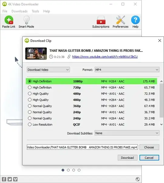

I have a hard time believing that software as advanced as youtube-dl does not have a straightforward way to get video of a certain size.
If you're interested in using a non-CLI solution that has an intuitive GUI, you might want to try this:
  1. Install 4K Video Downloader (the free version will most likely do everything you need).
  2. Choose your desired video download quality:
  1. Download:
