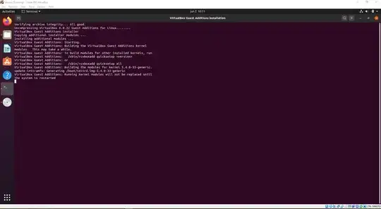

I assume you have installed Ubuntu 22 on VirtualBox 7.0 on Mac
  1. In VirtualBox settings
    1. Settings > System > Motherboard: turn up base memory
    2. Settings > System > Processor: turn up processors
    3. Settings > Display > Screen: turn up video memory to max
  2. Launch VM
    1. (on menu bar) Devices > Insert Guest Additions CD image...
    2. (bottom left apps) Show Application > (search) Settings
    3. In Setting > Language and Region, change it to English (United Kingdom)
    4. (bottom left apps) Show Application > (search) Terminal
    5. Make your user a sudoer
su -
usermod -a -G sudo <your username>
  1. Relaunch VM
    1. In terminal, run findmnt check the last line looks something like /media/<your username>/VBox_GAs_7.0.6 ...
    2. In terminal, run sudo /media/<your username>/VBox_GAs_7.0.6/VBoxLinuxAdditions.run
  2. Relaunch VM. Now you can manage your screen size with this icon in the bottom right menu bar. enter image description here
