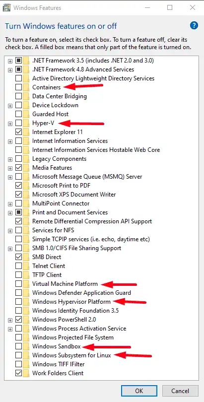

I've highlighted the ones I've heard are the ones that may conflict with it and as you can see they're all disabled.

  • @Ramhound - Just Malwarebytes, tried it with it closed too. Core Isolation is off, should I try it with it enabled? Not sure where to look to find those Guards. Yes I've ran the command; will edit post to show this. Also I'm not using either build but I am using an "N" version of Windows, I think this only effects Windows Media related software though. – Jezza Jan 17 '20 at 13:15
  • @CristiFati - It was the Virtual Machine Platform that fixed it but this too works with it. – Jezza Jan 18 '20 at 21:24

I was getting the same error. Leaving Virtual Machine Platform on made VM run.

I faced this issue after installing Docker Desktop and here is how I resolved this issue.
  • Open the "Turn Windows features on or off" settings (type optionalfeatures in the start menu or Win + R).
  • Uncheck "Windows Machine Platform" and "Windows Subsystem for Linux" .
  • Restart windows once or twice.
  • If you have Docker Desktop installed, then after restart you will see the following message.
I think the above message is telling that you have to check Windows subsystem for Linux and Virtual machine Platform for running Docker Desktop.
If you want to work on Docker Desktop again, you can check these options a see that are you able to use Docker Desktop or not. I haven't checked it myself so I can't tell you the result.
