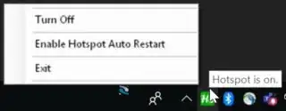

  • Alternatively, you can use this solution instead, which is a small app that resides in the taskbar tray area.

  • So, what I have used ultimately is an answer I found in the link you provided, it does the same thing the script does but is a dedicated app which resides in the taskbar tray area. https://superuser.com/a/1468845/99602 – Qwerty Feb 24 '20 at 09:16
