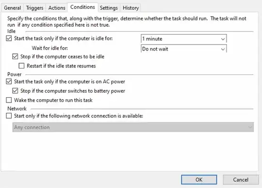

I've used Task scheduler and created a new task, added a trigger, set it to event: on Idle and created the task. In the conditionstab, specified the task waits 1min to become idle (instead of 10min just to test).
But then I wait for more than 10mins and the task is never triggered on PC1 but triggers on another PC2. Also if I press Run in Task Scheduler the task runs normally in PC2 it just never triggers automatically when idle for 1 min. I've checked online and found that PowerCfg -requests will show what is stopping the PC from being Idle and when I run it on PC2 nothing returns but when I run it on PC1 I get this "Legacy Kernel Caller" driver.
So I used Powercfg -requestsoverride but when I run powercfg -requestsoverride Driver "Legacy Kernel Caller" System , where it succeeds and I find it in the Powercfg -requestsoverride list, but then powercfg -requests it still shows [DRIVER] Legacy Kernel Caller under SYSTEM: and the task is never triggered any advice please?
Below is how my scheduled task looks in task scheduler:
Also here is the xml of my Task:

  • My task is not scheduled in the way you said, it's set to start when computer is idle for 1 min, but it never starts in PC1. Also if I press Run in Task Scheduler the task runs normally. I've updated the question with screenshot of the task details if you could check. – Tak Jul 15 '20 at 08:57
  • What is in the idle settings tab ? Did you set activation time ? It's a similar case with what I said in the answer. If it works manually means credentials are fine, you need to make sure activation conditions are good also. The settings part depend a lot on what the task does; more details are needed here like how much time must it run ? – Overmind Jul 15 '20 at 09:30
  • I’ve included screenshots including one of the settings tab in the question. The activation is to ‘start the task only if the computer is idle for 1 minute’. The task runs an exe of a winform application I made which is just a windows form that opens with some info then the user normally will close it down like any other window. – Tak Jul 15 '20 at 09:40
  • I meant what's under triggers --> idle/edit. – Overmind Jul 15 '20 at 09:54
  • I've updated my question with a screenshot of the triggers edit window and I've also included the xml of the task. – Tak Jul 15 '20 at 10:21
  • Set activate to a later than now time and use repeat if you want it to re-spawn more than 1 time. – Overmind Jul 15 '20 at 12:09
  • Okay will do that, will this make it triggered once the computer is Idle for 1 min? – Tak Jul 15 '20 at 12:11
  • Should fix the stating problem. – Overmind Jul 15 '20 at 12:44
  • Okay, will try it. Just to confirm so I will have to activate it only once (setting a time after current time) and it should work all the time in the future without having to reset it? – Tak Jul 15 '20 at 12:45
  • I just tried it and set activate to a later than now time and it didn't trigger. – Tak Jul 15 '20 at 14:04
  • There must be something else preventing it. As a general picture, activation conditions are a cumulative requirement so if only one condition is not good/not set, it will not work. – Overmind Jul 16 '20 at 05:41
  • Could you check this please: https://superuser.com/q/1568909/391215 – Tak Jul 16 '20 at 07:44
