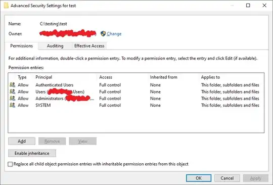

That's on an administrator cmd prompt, and I even set all the permissions on the directory to Full control:
