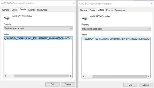

I also checked the DeviceEnum tab, and there I noticed that at around the same time as this time skip was a bunch of repeating entries that started and stopped the same 2 devices with ids
PCI\VEN_1022&DEV_7901&SUBSYS_B0021458&REV_51\4&3298272d&0&0042
PCI\VEN_1022&DEV_7901&SUBSYS_B0021458&REV_51\4&9b70dcb&0&0043

I noticed that the first part of the id (PCI\VEN_1022&DEV_7901&SUBSYS_B0021458&REV_51) is the hardware id of AMD SATA Controller in device manager. There are 2 identical AMD SATA Controllers there, could that be a problem? Can I uninstall one of them, or is this normal?

EDIT: I have found that these ids are certainly the AMD SATA Controllers:
controllers

I have solved the issue by booting into safemode and deleting both AMD SATA Controllers in device manager (with the checkmark "delete drivers"). After a reboot they are replaced by Standard SATA AHCI Controllers, and the system boots quickly, as it should.
