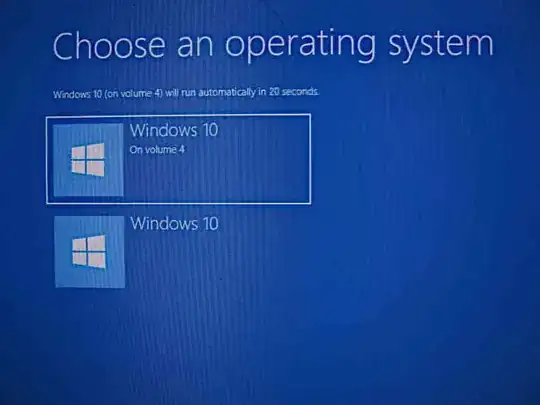

In this last attempt I even got Windows boot manager to run off of my m.2 NVMe, and it finds my clone. It is the second boot option. Selecting it will start a boot attempt; which goes into an automatic repair; which always ends up failing.
Booting from m.2 NVMe brings me now to this:

  • boot will now start into above Windows boot-loader; volume 4 boots and runs; but my old install (on volume 2) will not
