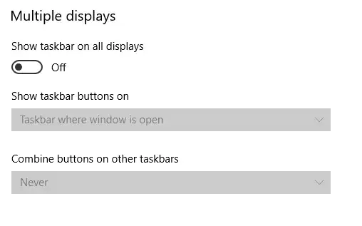

Next, need to change the task bar settings
  1. Start -> Settings -> Personalization -> Taskbar
  2. On the bottom, in the "Multiple displays" area, turn off "Show taskbar on all displays" enter image description here
That should do it.
