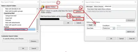

Considering that you need to manage some messages that need to be completed within a specified date, as a workaround, it's suggested that you could create a custom search folder which Follow up messages can be displayed in a folder instead of being moved. For specific operation steps, please refer to:
1.Under Folder tab, click New search Folder;
2.In New search Folder window, under Custom, double click Create a custom Search Folder;
3.Type the name for this folder, such as Follow Up;
4.Click Criteria… , type the Due Date and choose the condition, such as tomorrow;
5.Under Mail from these folders will be included in this Search Folder, choose the folder where the flagged emails are from; enter image description here
  1. Click OK.
