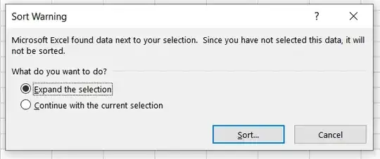

Select "Filter" from the drop-down menu. You will see dropdown boxes appear on your header cells, but let's ignore those for now. Click on the button again and choose "Custom Sort...". You will see a warning message:
Data range warning
Make sure "Expand the selection" is selected and click "Sort...". This will take you to a window where you can specify how you want to sort your data. For your example, I would suggest the following:
