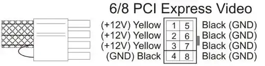

So for each 8 pin plug you need 12.5amps. Now you need to add all of those up. 6/8 pin connector
The CPU connector looks like this: enter image description here
So if you had a 8 pin CPU connect on the motherboard, and 2 8 pin connectors on your GPU that is already at a potential of 38 amps.
The situation is going to get worst from here.
You will have to be really careful as you could potentially be dealing with 60 amps, and required 4,6, or 8 gauge wire. One short circuit here and you have a major problem.
