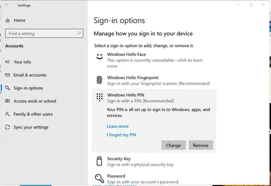

Log in to Windows with your password.
Go to Settings, Accounts, Sign in Options.
Click on PIN and a sub window opens.
Click on Change.
That should (and does) work. I am assuming you can log into Windows with a password.
Change PIN

  • Thanks. Different from the SS, I didn't have a Windows Hello PIN. Oddly, I added one, and now FIDO authentication asks me for it. When provided, I'm authenticated without needing to touch the key. It works, but that's not the behavior I want, I do want a physical action to allow my key to authenticate. I tried then to remove Windows Hello PIN, but now it asks again for the key PIN I have no idea what is. I added Windows Hello PIN again and it works again, but bypassing the touch. – Hikari Nov 29 '21 at 23:41
