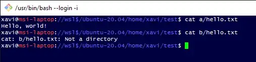

Snippet in linux
In gitbash, broken
When I go to the windows side, the symlink is broken.
In gitbash:
Snippet in windows gitbash

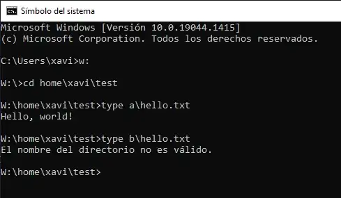

In CMD, broken
In CMD (UNC \\wsl$\Ubuntu-20.04 mounted in W:):
Snippet in windows cmd
