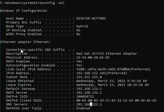

ADDENDUM 1: For the networking I have not made any explicit setup other than specifying the NIC virtual device to use virtIO. The virtual connection is the default NAT virtual network, which has created a virtual device listed as virbr0 in the ifconfig. No network bridging has been done so far, I've setup about as default as you can go.
Also on the guest machine, all I have is just the automatically configured local IP and that's it. No access to the host machine or router, at least as far as I'm able to read it. Here's a screenshot:
Screenshot of guest ipconfig

ADDENDUM 3: The output of nslookup in the guest machine:
  • I think you need to clarity whether you are e.g. bridging your VM to the host LAN, using an "internal" bridge and relies on IP/L3 forwarding, or the qemu "user" networking. For example, you will have no internet (and host LAN) access if you want the first but forgot to enslave a host NIC to the bridge. Also check whether you are getting any (non-[APIPA](https://en.wikipedia.org/wiki/Link-local_address#IPv4)) IP configured on the guest (assuming option 1 and your host LAN have a DHCP server working). – Tom Yan Mar 23 '22 at 10:40
  • @TomYan I've edited the question to clarify as best as I can. If the question requires any config pastes or screenshots, I'll be sure to add them. – IneptusMechanicus Mar 23 '22 at 11:27
  • I'm not familiar with libvirt, but sounds like option 2 to me. Do you see `192.168.122.1` being configured on `virbr0` in the `ifconfig` output you mentioned (I assume that was executed on the host)? Also share the output of `sysctl net.ipv4.ip_forward`, `iptables-save` and `nft list ruleset` (all run as root / with `sudo`). – Tom Yan Mar 23 '22 at 11:35
  • Inside the VM, everything looks fine. You should clarify how exactly you cannot connect to what exactly. Maybe use `ping`, `Invoke-WebRequest`, … and provide the results. – Daniel B Mar 23 '22 at 11:38
  • @DanielB the guest machine simply has no internet whatsoever. Browser has no connection, `ping` and the likes simply time out. The network device registers as working properly in the guest though. The problem appears to be somewhere outside the guest istelf i reccon. – IneptusMechanicus Mar 23 '22 at 12:17
  • @IneptusMechanicus I am not seeing anything wrong in your firewall rules, except as per the counters, the forward / nat rules that are supposed to be matched when the guest try to reach the Internet were not matched at all. So the only thing I could think of is that perhaps you should also check the per-interface forwarding sysctl with `sysctl -a -r 'ipv4.*\.forwarding'`. By the way, can you also confirm that DNS queries from the guest work (by testing with e.g. `nslookup`)? – Tom Yan Mar 23 '22 at 13:44
  • All the interfaces are set to 1. I've also added the output of nslookup in the original post – IneptusMechanicus Mar 23 '22 at 14:01
  • @IneptusMechanicus Hmm, have you ever tried pinging a *public* IP (e.g. 8.8.8.8)? (Btw, do you have any idea what generates your firewall rules? I just noticed there seems to be something wrong in `LIBVIRT_OUT`, but it's only about DNS queries to the host.) – Tom Yan Mar 23 '22 at 16:08
  • So pinging works, oddly enough. But accessing the internet over the browser doesn't work and running the diagnostic tool says the DNS server isn't responding – IneptusMechanicus Mar 23 '22 at 16:15
  • @IneptusMechanicus That's exactly what I expect. In `LIBVIRT_OUT`, `dport 53` should instead be `sport 53`, as unlike the case of DHCP, the source/client port number of a DNS query is not a specific port, so when we match the replies from the server, we need to match its source port number (which is the destination port number of the query: 53). So fixing the two rules (tcp and udp) should get things working. – Tom Yan Mar 23 '22 at 16:18
  • Another oddity is that I can ping the router, but not the host machine. I assume it's due to this same reason. In previous installation attempts the router timed out as well, but now, when I saw public IP-s working, i tried again and it worked. – IneptusMechanicus Mar 23 '22 at 16:20
  • @IneptusMechanicus All I can say is you probably need to figure out what those obscure `CXX[X]` chains are for and clean up your firewall (after confirming that nothing actually relies on them to work, maybe). The mistake in `LIBVIRT_OUT` I mentioned shouldn't actually cause any problem (as per your ruleset dump) if you don't have those `CXX[X]` chains as all the chain policies are `accept`. – Tom Yan Mar 23 '22 at 16:36
