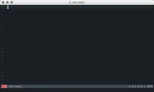

  • Command-T:
    Command-T is a Vim plug-in that provides an extremely fast "fuzzy" mechanism for:
    Command-T in action
