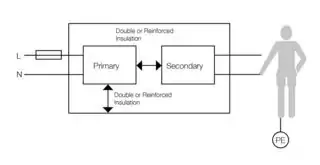

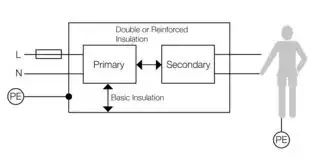

Contentious Claim #3 : If you must have chassis bonding to facilitate emissions, and you also must provide a path to electrostatic discharge to ground, then a non-isolated supply Class I is the most obvious standard.
Class I supplies require a PE connection, which was already (per claim #2) required to be electrostatic compliant and must be connected to ground for shielding compliance, and thus you see this little symbol on power supplies and systems.
source: https://www.idealpower.co.uk/what-are-the-differences-between-iec-power-supply-protection-classes/
The basic difference is that Class I supplies only have a single layer of isolation between the Power circuitry and the chassis, and thus a protective earth path is required for safety, and all metal sufaces must be bonded to protective earth. Subsequent, because it must also be bonded to EMI shields, and the shields are bonded to ground, this is where the connection between Protective earth and Ground is again reinforced, This is then reflected in the test by the Nationally Recognized Testing Laboratory which will specify (on a per-region/country basis) the requirements for the relevant label (e.g. UL in NA, CE in Europe, CCC in China)
Comparison of Class I and Class II from XPPower https://www.xppower.com/resources/blog/iec-protection-classes-for-power-supplies

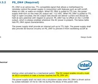

Interestingly, the Intel design guideline does mention a power supply feature in section 3.3.2 about the Power On Pin, but does not mention isolation as a requirement for any other pins.
A search of "Class II ATX supplies" (with roman numerals, not class 2) shows much fewer options in the standard locations.
